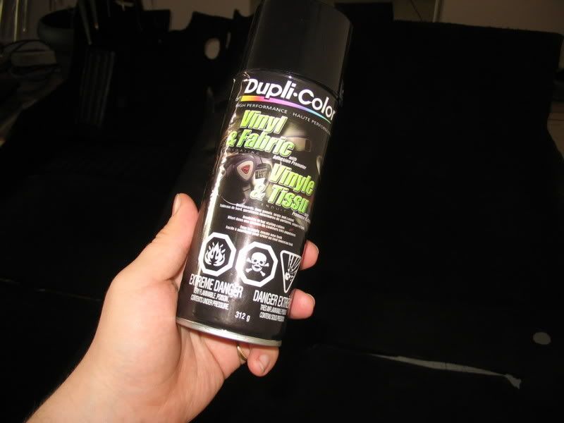

Originally Posted by static
black carpet is the shizt
It doesn't look dark enough(could be the flash), but still its an improvement. Hopefully it lasts.

yea, hopefully. It's not perfect i agree, but for $30 (used 3 bottles) and a bit of elbow greese it's still much better than stained light grey.
on the rust part: i also didn't see any rust at first (except for some surface rust around accel pedal). Then i noticed some cracks on the driver side asphalt sound deadening as if something from underneath pushed it up a bit. So i decided to tear away the whole side and found several spots of surface cancer starting. I cleaned it up and covered the whole driver side in POR15.
as for good carpet cleaner: i used OXY brand bought in CT and it worked wonders on stains (you gotta do some massaging with a brush).

paint dried in like 3hrs, i gave it a day just in case. Because of the nature of the carpet (the bristles or whatever you call them, can be swayed to one side or another) what i would suggest is to sway all bristles to one side with a brush, paint, wait till it dries, then sway them to the other side (the opposite motion with the brush) then you'll see some grey protruding from the new black in tiny patches, paint it again. This will make it more uniform. (kind of like the same idea when dying hair)
do you mean rear deck? Yes i painted it as well, same paint, came up pretty good
IS your carpet painted on this picture?
Looks stock!!
I also did mine on the convertible last month and what a difference from gray..it looks like a complete new interior with the black color.

it looks like that because of flash, it is pretty black in real life.
It is a huge difference in color comparing to what it was (light grey)
