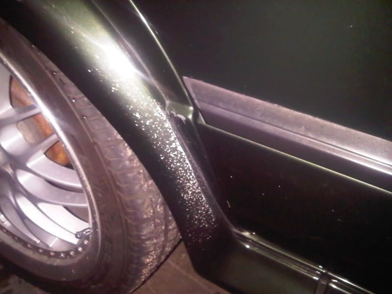

they say to use the brushes, but I blobbed a bunch on a paper towel to apply it to a large area, still worked fine. Did my whole car almost on 1 kit lol
before
after
Valance right side done, left side untouched
Bunch of stone chips on the bottom of my doors as well, so it gave a milky look almost, did those and viola, they look brand new.
And don't buy the extra large kit. I bought 2 thinking it wouldn't be enough., I did almost the whole car with 1/4 of 1 bottle and another bottle to spare.
