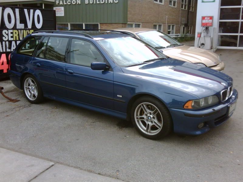

Yeah, they are awesome. Wagons with the M sports package are pretty rare, I have only seen one in Toronto in Topaz Blue Metallic, the cousin of my 540i/6. Even has the Style 66's - which I am looking for a good set if anyone has some for sale...
That said changing the bumpers and trim is easy, just $$$ if you go OEM. The above 23 examples also have M5 mirrors if I'm not mistaken, pretty sure all Tourings even with M sports package came with dumbo ears.

I think you were looking at my car! (now mine anyways!)...
Owner kept the rims, and car how has M5 driveline/6spd.

Hah, that is awesome... I snapped the pic in the Davisville / Mt Pleasant area in 2009, or around there. Was it as nicely maintained as it looked?
I'm jealous, but glad you have it! Especially since it's basically an M5 now!
