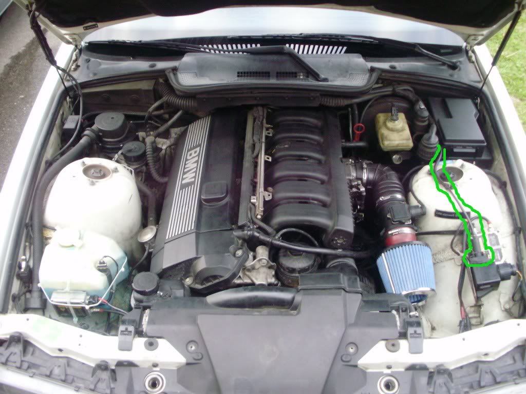

Also, does anyone know what this is?? It seems to be some sort of cable (like a throttle body cable), but it is not connected to anything on the other end on my car. It has a big connector to that black box, then just ends off near the firewall as a loose ended cable.
Jardine is offline   Reply With Quote
im not sure im pretty new to e36's but i think thats something to do with the cruise control.

yep, someone on E36-Tech clarified that for me. It's not connected on the other end, so that might explain why my cruise control doesn't work lol. I have the M50 throttle body, so maybe there is no where to connect it?? I haven't really looked. thanks though!
