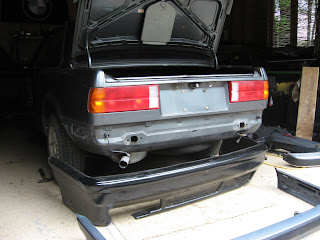

Trial fit of the rear bumper "rieger GTS".... will need to make custom braquets to hold it in place..
Made Fiberglass caps to replace the existing front floor ones , used seam sealer and finished lining the driver side....just have the passenger sides to be done now then the Floor pans are DONE!!
