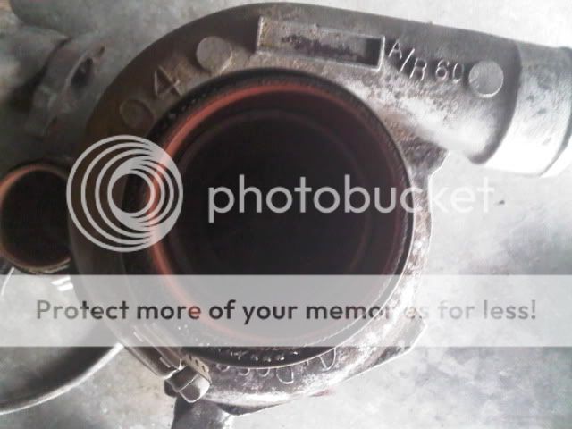

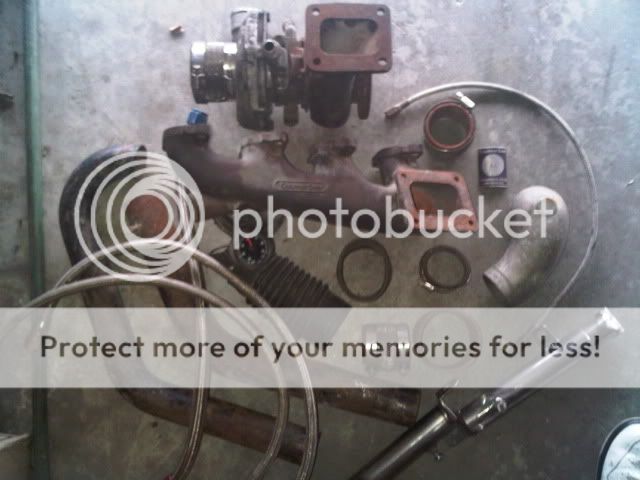

Is that an old m10 Callaway?
Looks like one I picked up for free in Virginia. I think I got everything except the exhaust down pipe.
[IMG]AiResearch t04 turbo[/IMG]
[IMG]free parts[/IMG]
Anyways, just thought I'd share, look forward to your progress.

Haha nice score! Yes sir, it's an old Callaway system, but I only have the manifold and turbo, none of the other bits. It's fine, because I plan on running a FMIC anyways, and the original setup wasn't designed that way with the charge pipes running across the top of the engine bay. Oh yeah, I've also got a 2.5 inch downpipe for mine, but I want to make a new one in 3". Are you planning to install yours?
