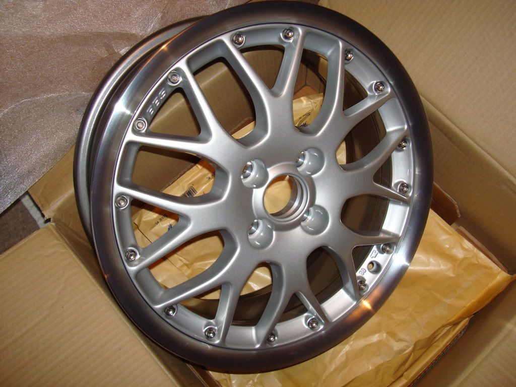

Sorry for bumping an oldish thread, but need to know whether the following wheels will fit a stock E30 with no suspension/arch mods?
BBS RS 764, 16x6.5 (4x100), ET45 with 205/45/16 tyres.
And are they a good choice in general?

Not a good choice, they are too skinny and too high in offset. Would require 30mm spacers to begin to look nice.
