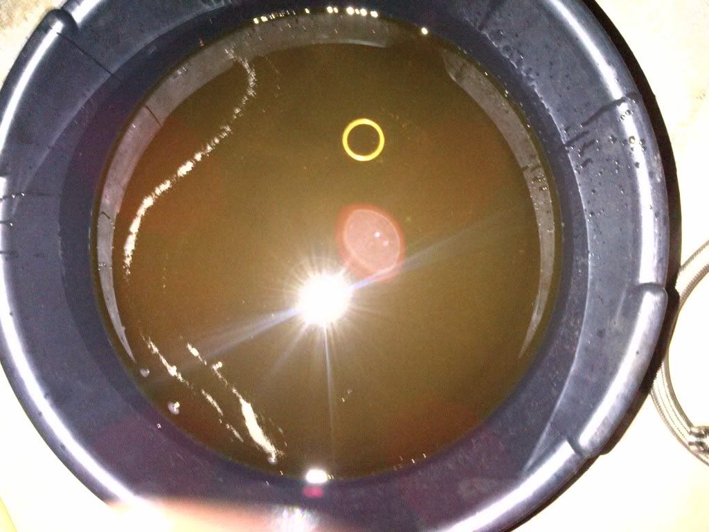

After close to 2 months of procrastination i've finally removed both axles while managing to strip off on torque lug, took the diff cap off to inspect inside. I can take photo's of inside the diff and closer ones of the axles if you guys would like but for now from all that i can see and need are both rears. Got prices from partsource and axle automotive. Came to under 500. I don't even want to bother with oem prices, so any other suggestions where i should look?? Thanks guys
Clean diff fluid
I also haven't check the guibo yet but will soon, thanks for bringing that to my attention bear!
