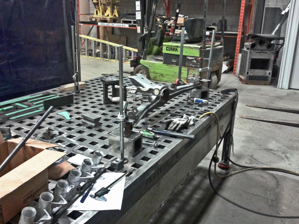

So yesterday I spent about 5 hours at work in the morning milling the adjuster plates out of some 2"x 1/4" flat bar and then modifying the rear subframe...

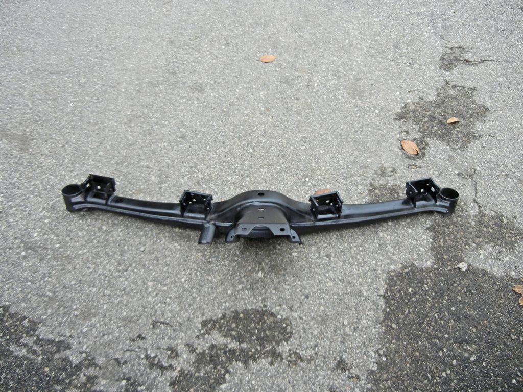

Then when I got home I painted it...

Going to press new bushings into the trailing arms tomorrow and get the subframe back together and back in the car. Then I just need to try to fix the oil leak on the front crank seal, put the front of the motor back together and take the car for an alignment. If things go well I should be able to make it out next weekend.

... I'd be lying if I said I wasn't jealous of that totally pimp work table. I gotta get me something like that (and the shop space to properly make use of something like that).

Ya really. Nice work with the rear end
[/URL]
And this afternoon I installed my shiny new gas tank along with new rubber fuel lines and such...
Nice work! I was deciding what to do for my rear end on my ti and after some research & discussion I decided against the weld-on adjustmentationerz. I went with the shorter AKG bushings to raise the subframe a few mms to dial out some negative camber that way, along with poly TA bushings. What TA bushings are you going to use?
Yeah I know, it's not an optimal solution because you're skewing the axis of the RTABs relative to the subframe, but short of doing a DTM style rear trailing arm modification it's pretty much the only option because the eccentric bushings are garbage. I'm running stock rubber bushings to help gain a bit of compliance with the twisting going on. Poly bushings with the aluminum core in Canada are a bad idea unless you are taking them apart once a year to clean and lube everything... ask me how I know
LOL, my e30 had poly bushings for 2 years or so but I never tried driving in the winter so when I parted out the trailing arms they came apart w/o much issue, I could see it being tough with the slightest bit of corrosion. I was and still am uber curious to see how things woulda turned out if I went with the slotted subframe but the bushings I got are good to take out hopefully a 0.5 degrees of camber and as for the toe raising the subframe helps out with the progressive toe curves when going low apparently. The rest I'm just gonna say a prayer and keep tabs on my tire wear
Did your old akg TA bushings squeak much with their "grease grooves"? my old IE TA bushings had no grease grooves and creaked like crazy, but I loved the fuh razee
