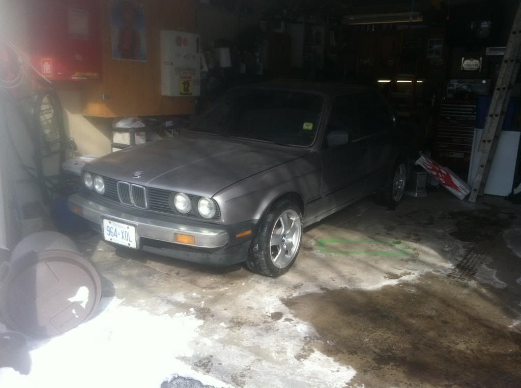

just bought this car, 87 325i thinking about doing an m60 swap. I bought Frank Macaluso's book and have been reading through that

Buy my m30 swap. M60 is not a swap for the feint of heart.
