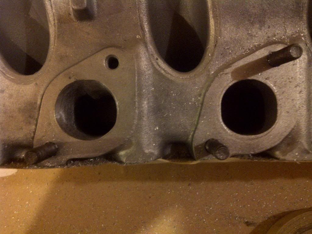

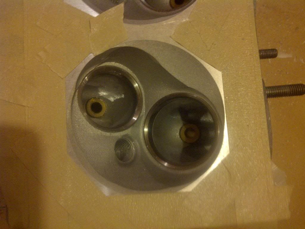

This build somewhat started in the fall when I was rebuilding my head and changing the timing belt.
I replaced the valvesprings, decked the head, polished the combustion chamber and gasketmatched the exhaust ports.
Before:
After:
Left is polished, Right is stock

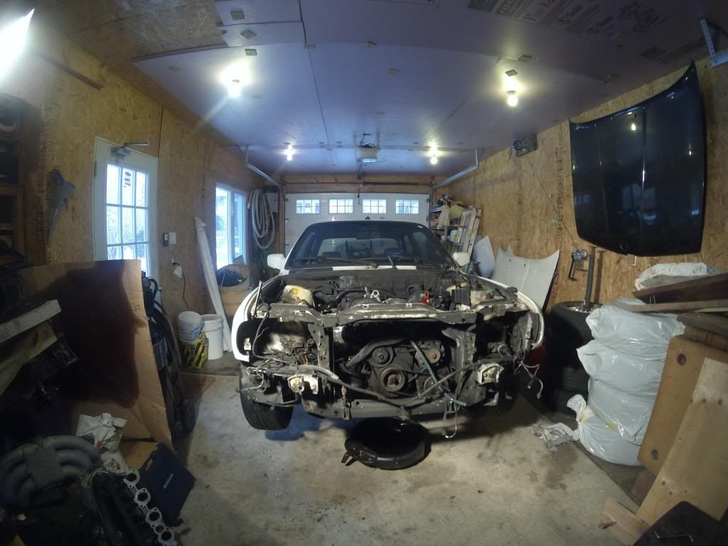

In the beginning:
End of Day 1: Have the front end apart and rad out (yes the pile of garbage just got pushed out of the way lol)

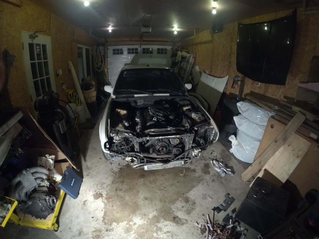

End of Day 2:Intake, Exhaust, Oil cooler are gone

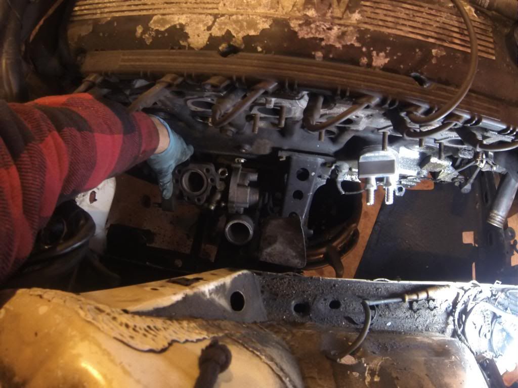

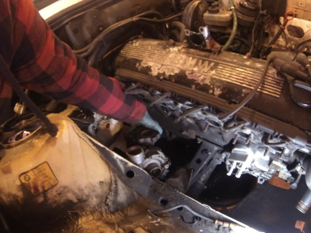

Day 3: Have to make sure the Turbo's fit somehow... Managed to rotate the compressor housing to be able to clock it better in the engine bay. I'll end up dealing with the oil and Cooling lines after, as long as I have access to route the lines/fittings. The rear turbo will be sitting close to stock but the front one will be rotated almost 180 deg (top facing down), so I should be able to swap the oil drain with the inlet..TBD
There are 2 ways I am thinking about placing the rear turbo
Way 1: works better with exhaust flow into the turbo, but I think I will have problems with packaging the exhaust from the front turbo and the exit of this one. Fluid lines wil be easier to fit though and a gravity drain I dont think will be a problem

Way 2: Have to make a new engine mount, but exhaust packaging should be easier. Might need a scavenge pump for the oil though
Front Turbo:
So a couple things I am thinking about:
1. What position should I mount the rear turbo?
2. Should I swap the front and rear turbo? or get a second twisty compressor housing
DIY is offline   Reply With Quote

I think the best way to package them would be to keep them inline if possible. M20 examples I'm sure you've seen...
And the obvious RB26DETT...
http://upload.wikimedia.org/wikipedi..._GT500_001.JPG
Or it maybe possible to stagger them closely together up front like this...

Yah I have seen a bunch of those, the reason I chose the position that I did is so I can have a straight section at the beginning of my downpipe. I'm going to try an build a divider into the tube, separating the wastegate and turbine exit. I have a chineese turbo I'm going to use for some testing to see if its worth having a diffuser at the turbine exit as well (read something on power generation turbines).
here is a pic I had found from what I think is an Alpina done M20 twin turbo if there was such thing...Cant remember where I got this pic
EDIT: here: http://www.bimmerboost.com/showthrea...ITURBO-346-507

My 0.2 cents on turbo placement is make sure you can actually assemble it once its all in the car, home made systems that arent thought out can be real ****y, especially TT. I don't think you will have an BC issues as they're IG turbos.
Have you thought about how your going to plumb the coolant for them? Also on the oil return of the lower turbo, you were mentioning a scavenge system, you will probably need to have the turbo drain to a small reservoir then have the scavenge from there (this could hang right off the drain fitting).
You didn't mention what your going to do with the HG. Any thoughts on that yet?

I was going to V-band the crap outta my exhaust system so hoping it should be easy enough to assemble.. the reason its taken this long to get an update is so I can plan the front end properly (and work ).. havent though about plumbing the coolant yet reallythough. I was considering taking it from the drainplug but it probably wont flow enough.
I might try knocking in the firewall a bit so I can raise that turbo but I havent measured how much height I need yet. Makes life easy if I dont need a scavenge period.
