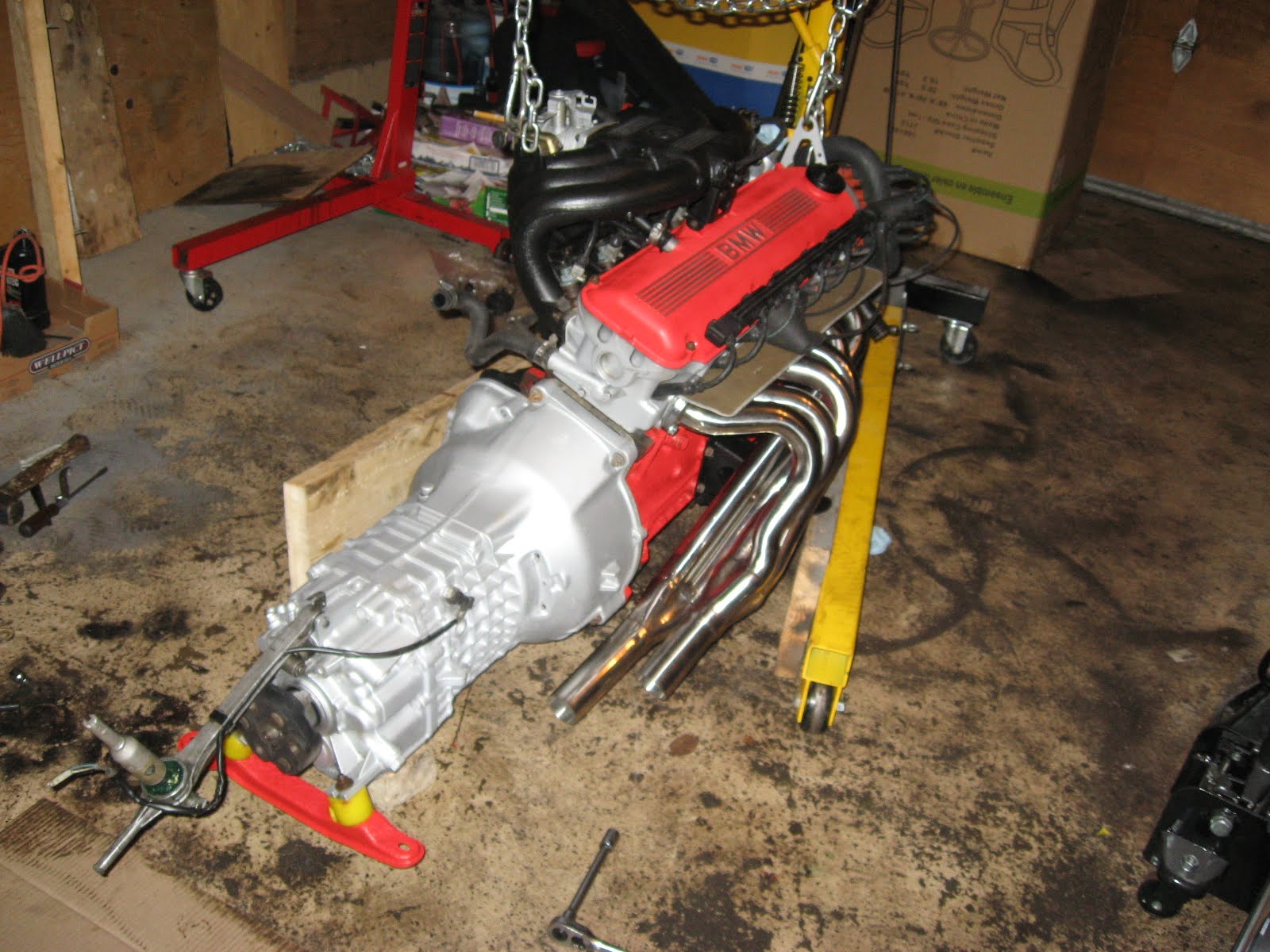

coming together nice that valve cover is very familiar to me..lol...
Cant wait to hear this engine fire..
Denny

damn that is sharp. trying to imagine some RD headers on there..
Old 06-07-2012, 09:48 AM   #123
Posts: 5,937
No kidding. Up until Monday things were looking pretty bleak, 7 weeks late, hadn't heard any news for weeks then all of a sudden they are ready lol. I'm hoping that they look spectacular.

Bullet...your engine is ready to be dropped in now!! lol...

^^ LOL
Definitely a couple similarities between the two. Your block is red though... and my headers are going to look a bit more wild than those
My engine is hotter then yours sorry man... its true LOL joke for sure your headers are going to be a lot wilder and high quality...keep in mind what manifold is going to replace these very soon
Cant wait to see the startup vid for this crazy stroker engine
