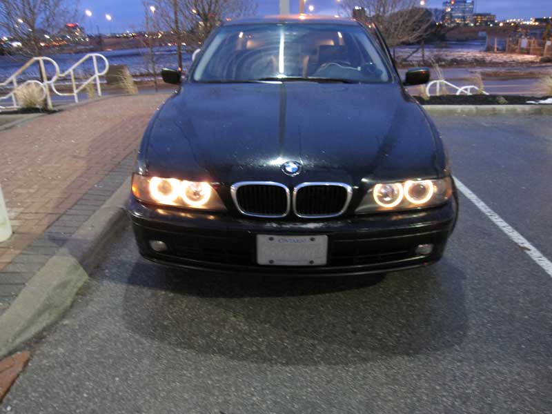

All i know is this 1st pic is my stock AE's, you can remove the inner bulb by pushing down and turning.
as you can see, if you remove the bulb, the parking light goes off as well.
These are the bulbs i bought at Canadian Tire for $2.99
here is the stock bulb (the bottom, pointy top, compared to the CT one (on top) i put a penny to show u the size.
Finished product looks exactly like OEM even at night.
