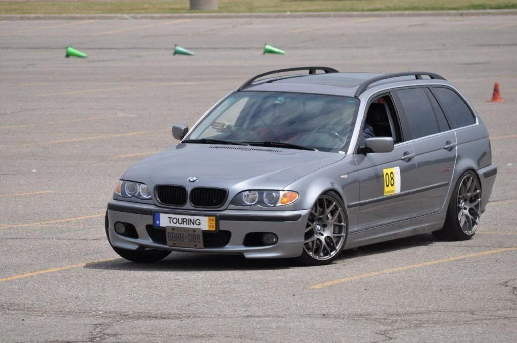

Here's mine:
http://www.skootermedia.com/wp-conte...6/DSC08786.jpg
mgunter is offline   Reply With Quote
Great pic. Just picked one up last week with only 100k on it. Mods are being planned.
