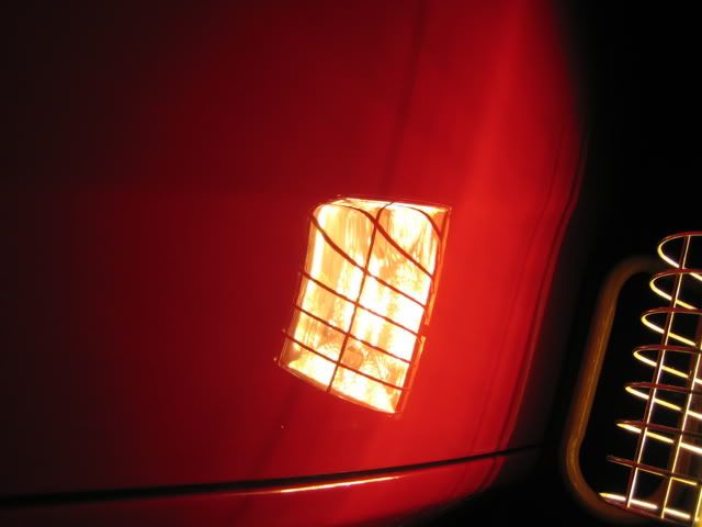

so heres a couple pics of the hood
process was ssr3, 2 passes with ssr1, klasse AIO (amazing btw, i suggest everyone get this), and klasse sealer glaze.
so i have 2 questions now, after i apply the sealer glaze, can I apply a wax right away on top(i've heard this gives it that extra 'wet' look to it) or should i wait a certain time to let the sealer cure?
also do i have to worry about polishing too often, or should there be quite a bit of clearcoat that ill never wear through it. (this is after using the ssr3 as you can tell it removes some CC by the haze it leaves)

give it 24 hrs to be safe. Depends on the sealer that you use.
looks awesome, nice job.
