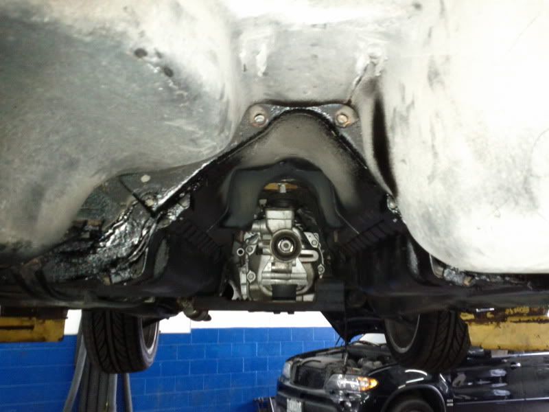

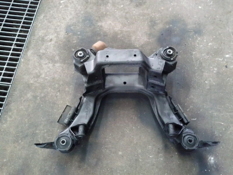

The car is in pieces right now, too be back together for Bimmercruise. Reinforcement plates are already welded in. The subframe just needs the Alu bushings pressed in along with new rubber diff mounts, control arm bushings, and Rtabs. Gonna be sweet, Ive been waiting way way too long to launch the car at 4000 RPM.
While everything was out I took the day off work to clean up the underbody a bit. I first painted with tremclad rust paint. Then covered that with a layer of asphalt paint. Sorry for the crappy cell pics. My hands were a bit too dirty to use the DSLR.
Before:

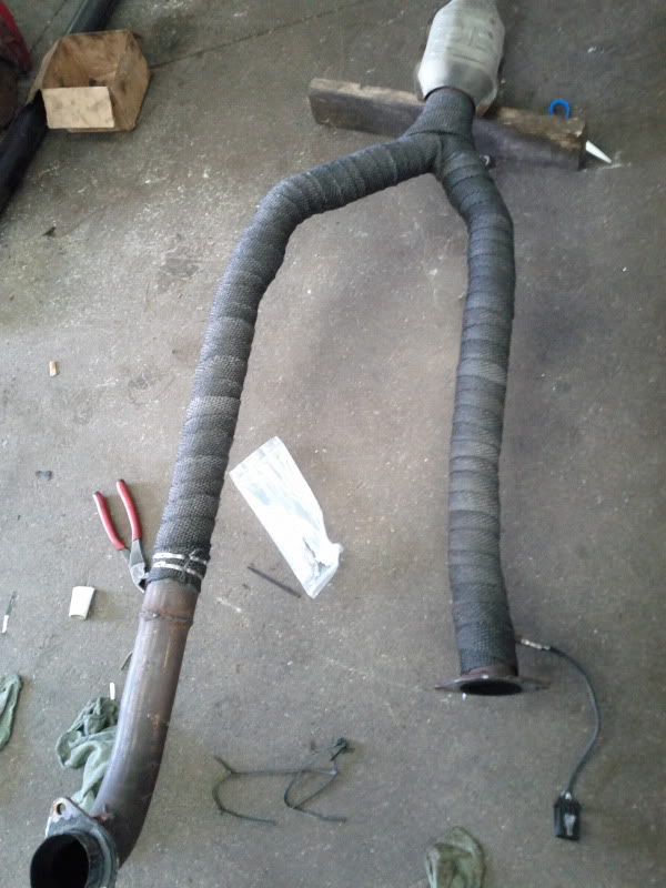

I also wrapped the exhaust so I get a bit less heat in the cabin.
As well as the clean and spray the subframe.
