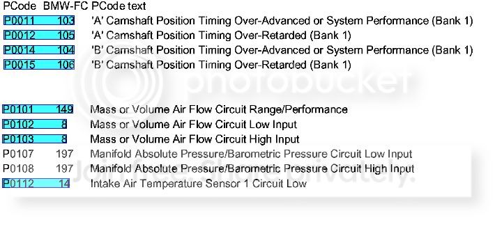

EuroSpec_92 06-11-2010 10:10 AM
The code shows as a bmw-FC code.
There is no P0104.
So if it is the FC code it is Camshaft position timing over advanced. Or system performance bank 1.
Picture attached.
http://i856.photobucket.com/albums/a...n320i/code.jpg
